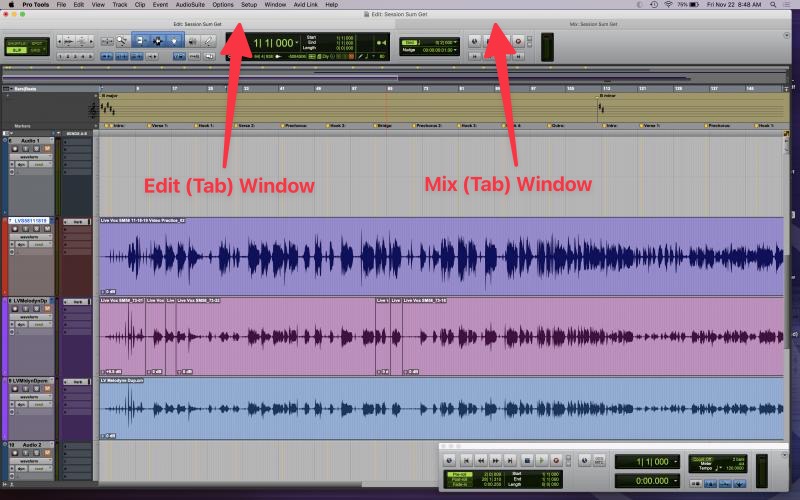

here is image of this.

sorry, couldn't embed image, but link is reputable & safe

No. this is a Mac settings.
Preferences>Desktop & Dock>Windows & Apps> Prefer tabs when opening documents [Always]
Go back to Pro Tools and close either the Mix Window or Edit Window. Then reopen either window and it will appear in a tab.

i tried that , and had those settings, and i can't make it happen,
you did it on Sonoma, and Pt Studio 2024.3 ???
all that happens, is it switches from edit, to mix, (when on 1 monitor),
it never creates a TAB, as seen in my pic above
i think this is a thing of the past but....
would LOVE to see that happen, can you confirm? make video?
