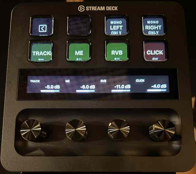

So far I have almost everything setup the way I want. I am not able to figure out how you assigned more than 1 source to a knob like you have in the photo above.

Multi Mom setup. It requires more network interfaces on your system to fake DADman out. It's in the text in the zip package how to do it. (each of those knobs is a different virtual MOM)

This works most reliably with static IP addresses for both the primary address and all aliases. Once it's setup it tends to be fine, my friend and colleague (who provided the StreamDeck+ photo above) is running eight virtual MOMs on his system!

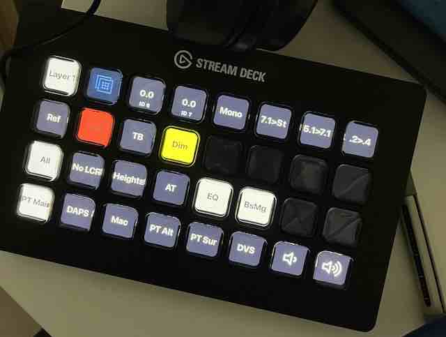

I just setup a Stream Deck+ with DADman and a MTRX Studio. So far so good. I got the basics going, now have to delve into the details.
