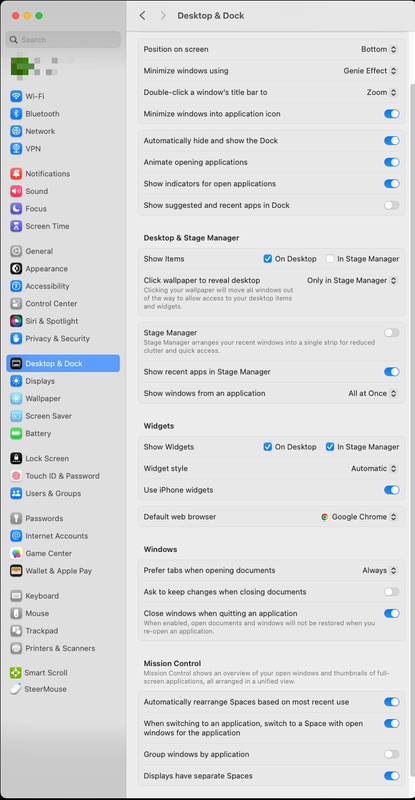

here are my settings... (See pic in link)
what else?
would love to figure this one out,
thx everyone!
Sonoma 14.4.1
PT Studio. 2024.3.0
https://i.postimg.cc/LsGCYq5s/desktop-dock-settings.png

You might want to block out your Apple ID on that screen grab.
That's all it takes on my system to get the tabs. Seems the same for everyone else. Perhaps you have some other software running that's conflicting with this Mac pref.

its2loud, your settings look different from mine,
doesn't seem you're on Sonoma,
i blurred out my Apple ID, thx

Turn off these prefs.

OK I (think) I have figured out a few things
And I now think it is a BUG in at least in Sonoma 14.4 ON my M1 Pro MBP = (Mobile in sig line below) and PT Ultimate 2024.3.0 in Dark Mode
I was fooled earlier about it working in Dark Mode and will explain
#1 If before I open any sessions, I set PT to Dark and then open existing sessions or create new ones it does not work
#2 If before I open any sessions, I set it to Classic and then open existing or create new sessions it does work and can be saved and will reopen with it working
#3 If I set PT to Classic then open or create a session it works,, and If while the session is open I reset PT to Dark ,, then it will work also (this is why I thought it worked in Dark before.)
BUT If I save and close the working Dark mode session and then reopen it it does not work
And here is how I have my Mac OS Systems Settings set
